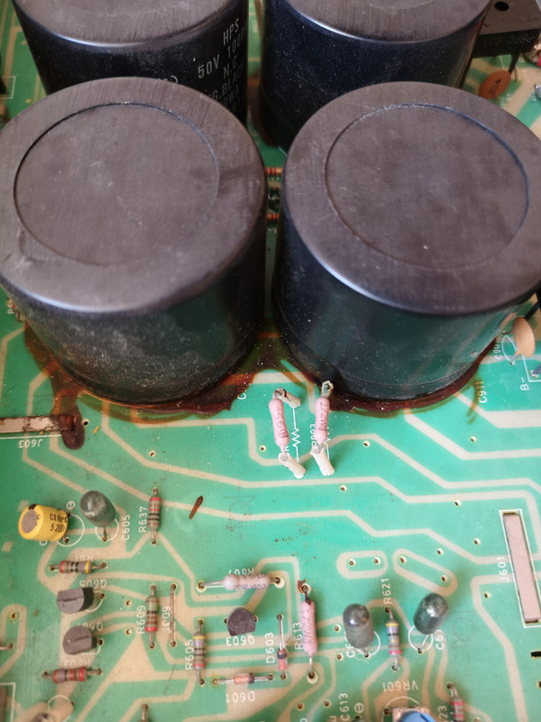

Does anyone know if Rotel glue in their big power supply caps to the pcb, as I have seen suggested elsewhere, or am I on a bit of a streak of leaky ones?

The old 820/840 series certainly had glue on the large caps, which ends up looking a lot like leaky discharge as the years progress.
No that looks just like the stuff I'm talking about! It's just not what you'd expect inside a professionally assembled unit is it?
So I'm now wondering if I've misjudged my 850 power amp's failure and it might well be something other than the big caps...

https://i.postimg.cc/Qxk3ghDq/IMG-20220327-125746.jpg
Generally, these all look nice and hot melt glue like before the ravages of time and temp take their toll and cause all to petrify.

You need to clean that glue off. It tends to corrode any component legs it touches and causes havoc. I regularly have to deal with this is Marantz and CD players and usually end up having to replace a bunch of wire links and components that had glue on them.

Yup, it's a bugger to shift but needs to be done. I get the worst off by chiseling it off with a blade or old screwdriver then clean further with IPA and cotton buds.
I was reading earlier that someone uses chopsticks sharpened with a Stanley knife to clean off old glue. It doesn't damage the board like metal can, and obviously you can easily keep resharpening them.
Good idea. I sometimes use a sharpened ice-lolly stick.
